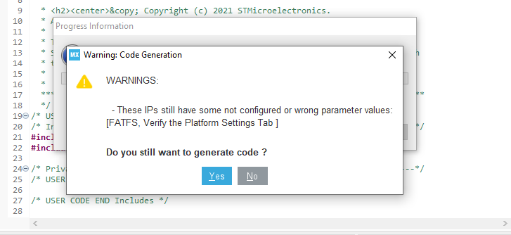

I adjusted the RCC clock and selected SDIO 4 bit wide bus bit and FATFS (SD Card ) and when i generate the code I get this warning message

Can anyone help me to fix this warning ?

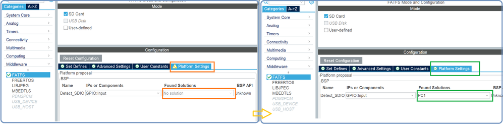

In fact, you need to select a GPIO input then add it into FATFS configuration/ Platform Settings to avoid this warning (as mentioned in the image below), then the warning message will disappear:

2021-04-05 1:06 AM
Hello
This warning says that CD pin Card Detect pin is left unconnected.. In this case fatfs assumes that card is always inserted. Just ignore it.
