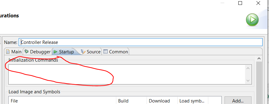

thanks, but no, this removes the breakpoints in the IDE. I want to keep the breakpoints in the IDE for debugging, just clear them from the device memory when running a release version. I guess there should be some initialization commands in the run config, but I don't know which commands are available there.

no no. I assume the breakpoints are somehow still in the memory of my stm32. during "run", I don't want them there, only during "debug'. So if I click on run, the breakpoints can still be in the IDE ( I might need them again in next debug session), but they should be removed in the stm32 during run.
I hope that makes it a bit more clear ;)
