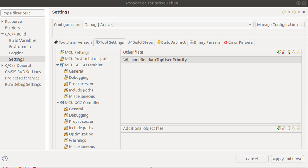

2020-05-27 10:46 PM
HI @Panometric ,
thanks for your support. I tried it... but it doesn't work.
I added the code in main.c
And the linker setting I added in build options (see image)
I can "enter in debug mode" but debugger not works. The eclipse show that app is running, but I can't resume, stop, step, ... and board doesn't do a nything
I attach the console output
Thanks for your tiem
Regards
Jordi
