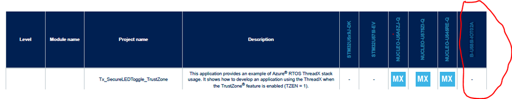

I Have B-U585I-IOT02A development kit for our project purpose.
we have created the project as per the below configuring
- Enable trust zone
- Enabled TreadX in non-secure region
- Created API Secure side Toggle LED and called through NSC region
Also, configure chip through cube programmer for secure region bank 1 and bank2
but we are facing hard faults when we call the NSC region api.
Can you supply a similar example for B-U585I-IOT02A based on the screenshot I took of the same example that is available for different series?
Also, provide a step of chip configuration through the cube programmer
Thanks
