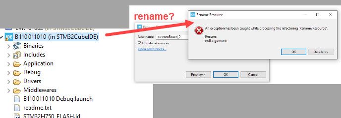

How can I rename the project-name in STM32CubeIDE ?
If I right click on the project(name) and choose rename I get the following error, see attached screenshot.
Thank you

Hello @pk84,
Edit the name in the .project file. By default, the name is the root path of the application, but can be changed.
<?xml version="1.0" encoding="UTF-8"?>
<projectDescription>
<name>new_name</name>
<comment/>
<projects>
</projects>Best regards,
Foued

2022-11-04 6:13 AM
ok thanks, will all other files like .launch be renamed automatically? I think there are for sure some more files with the project name and reference to it?
2022-11-04 6:19 AM
It's just necessary to change the name of the project and everything works fine :beaming_face_with_smiling_eyes:
