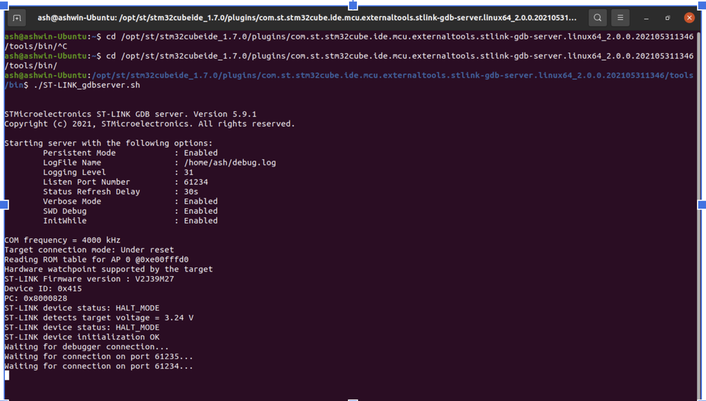

I have connected the nucleo board to a linux machine (Ubuntu) and have started the ST-LINK_gdbserver application from /opt/st/stm32cubeide_1.7.0/plugins/com.st.stm32cube.ide.mcu.externaltools.stlink-gdb-server.linux64_2.0.0.202105311346/tools/bin/
After I run the application the terminal window shows the following information.

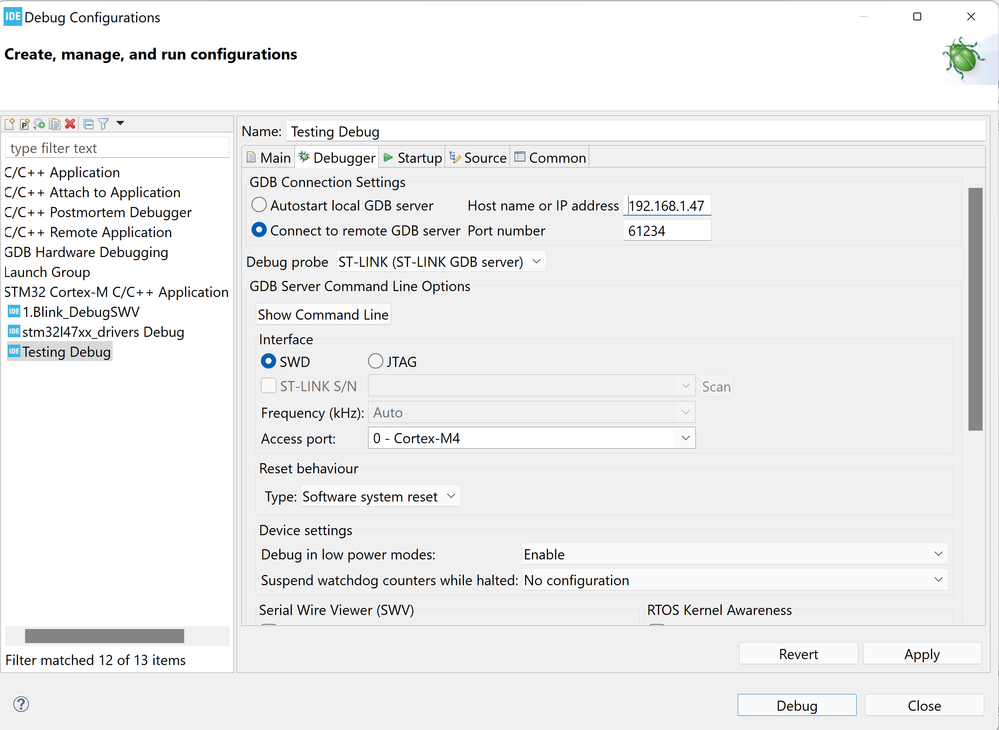

The stm32Cube IDE is running on the local pc(windows) which is connected to the network. The debug configurations is configured as follows

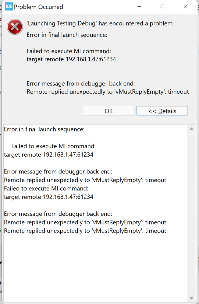

When I try to debug the application the following screens appear

I have tried the same replacing the UBUNTU with an windows pc and running the ST-LINKservergdb.exe. Now I am able to debug the code. Does this bring any direction to the issue with the OS being used.
How can it be used on an Linux distribution?

If still not working. Can you provide some more logging information:
This console should output all communication between the IDE and the GDB-server. Can you provide the output?

The connection seem to work well which contradicts the initial error dialog you received with Failed to execute MI command: target remote...
Can we do a screen share session? Drop me a PM and we can have a look...
