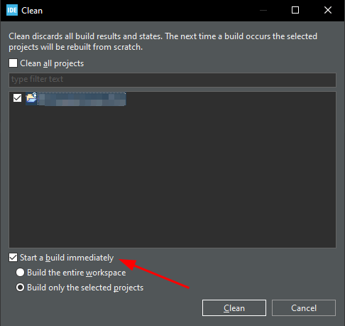

2022-07-12 3:04 AM
You could always right click on the project in the Project Explorer view and select "Clean" and then click the regular build button again for similar results.
Clicking the build button without this first step will continue to make incremental builds.

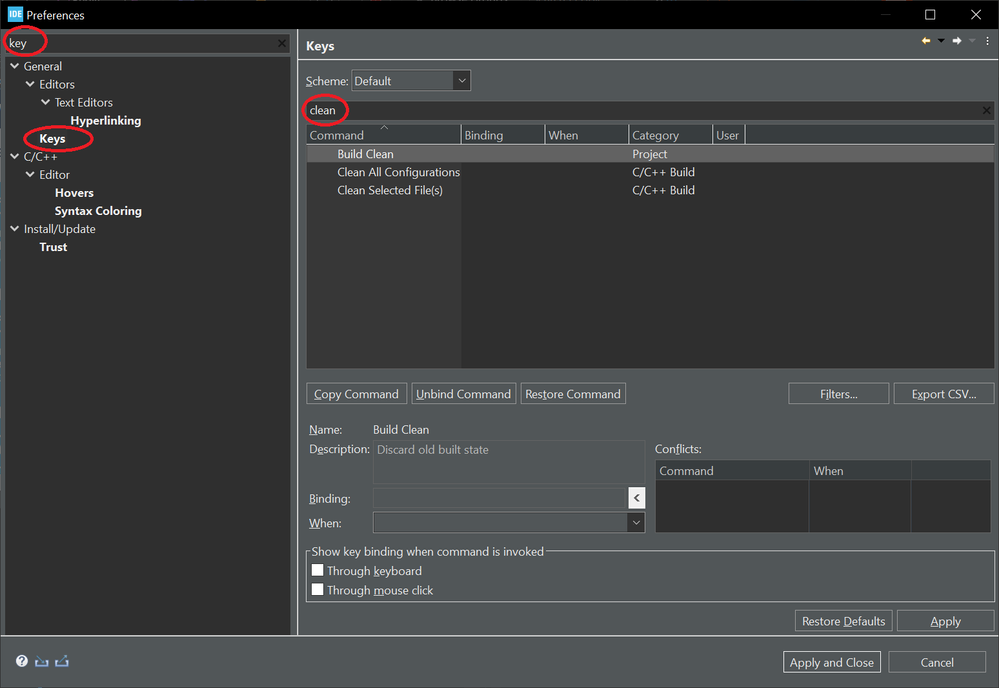

2022-07-12 3:34 AM
Perhaps you could try to bind "Build Clean" to some easy shortcut for you to use? You would need to have the correct project selected (or have all unrelated projects closed).
2022-07-14 12:44 AM
Thank you, I will try it.
I think this will be better than the option to right click on the project.
2022-07-14 1:03 AM
The "Build Clean" shortcut will rebuild with this option.
