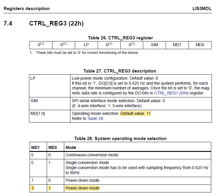

OK, you confirm that I2C communication is functional.
You need to pay attention to CTRL_REG3 (22h). If I understand correctly, conversion is off by default (Power-down mode), so the value is invalid as you said.

I can confirm that my I2C communication is functioning correctly because I successfully read the expected value from the WHO_AM_I register. However, when I attempt to read from the output registers, I encounter an issue – I do not receive any meaningful output. Strangely, the data I retrieve from these output registers remains static and unchanging until I physically unplug the device. After reconnecting and rerunning the code, the output values  change to entirely other number. I looked through the documentation and I am pretty sure there is no initialization I need todo to read the output register. Also, I am using a steval-mki137 that has a lis3mdl on it and it says it needs a 100nF capacitor. Could this be the problem?

You need to pay attention to CTRL_REG3 (22h). MD0 and MD1. For continous messurement you need "00"
