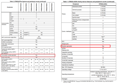

I'm using 2 kinds of board for i2c.
One is U575ZI-Q for master and the other is L432KC for slave.
The two devices feature RNG (random number generator) as shown in their respective DS:
You can inspire from one of the examples of RNG. Example:
https://github.com/STMicroelectronics/STM32CubeL4/tree/master/Projects/NUCLEO-L432KC/Examples/RNG/RNG_MultiRNG
