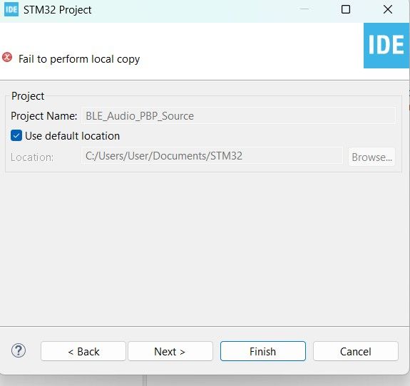

From yesterday, after selecting the example firmware for STM32WBA55G-DK1, in the final step of the process, the new warning is coming, saying "failed to perform local copy ". Kindly help me to resolve this issue.
Thank You.

Just a guess...
Disk full?

2025-11-21 4:41 AM
No, more than 50 GB of space available.
2025-11-21 4:51 AM
I am using STM Cube IDE Version of 1.16

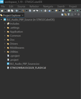

Hello @Sandeep_k ,
I reproduced your request on CubeIDE 1.19 and I successfully imported the BLE_Audio_PBP_Source Example.
Could you please try to change the default location path.
Thanks.

2025-11-22 3:25 AM
Even after installing the CubeIDE 1.19, its showing the same.

@Sandeep_k wrote:
Does that location actually exist?
Can you copy anything to it "manually" ?
2025-11-26 2:51 AM
Thank you, after reinstalling the stm ide and cubemx, now its working fine.
