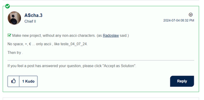

It's not showing ...
It should get a tick and green background - like this:
