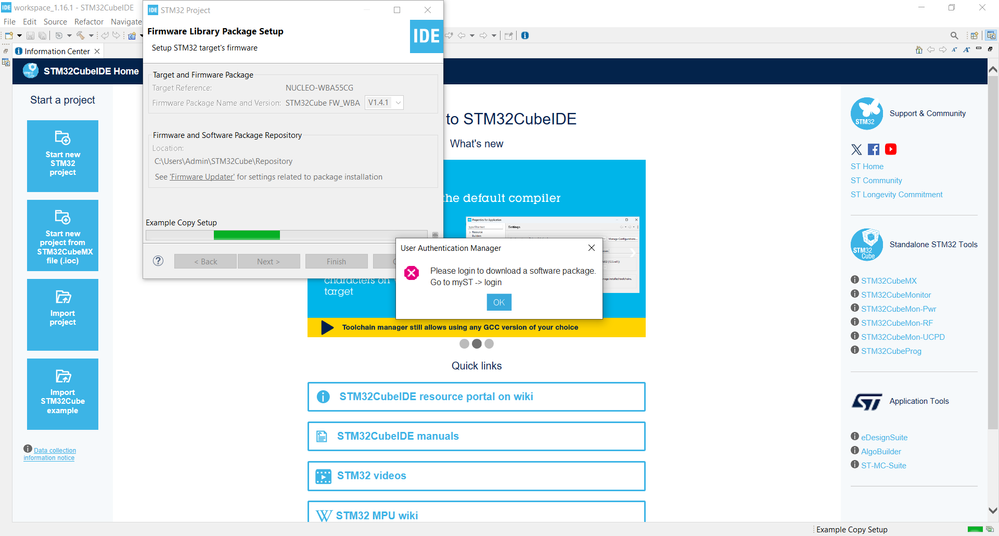

on a brandnew PC with Win10 i installed CubeIDE 1.16.1.
After that, i want to import example project "BLE_HeartRate. Then i got this message:
I thougt that CubeIDE installed the required Firmware Package automatically?

Hello @ledi001 ,
First let me thank you for posting and welcome to the ST Community.
In order to download the firmware package, you need to establish the Internet connection and log in to your ST account.
I suggest that you take a look at this Post.
Thanks
Mahmoud
