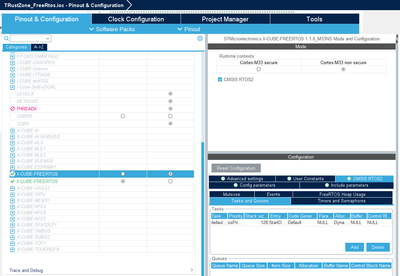

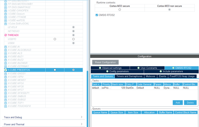

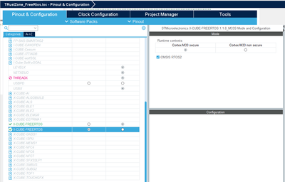

We are using product STM32H56 series , I am encountering problem while building my project
I am using STM32cubeIDE , trust zone enabled .
I enabled X-CUBE-FREERTOS M33non secure
In software package I installed -STm X-CUBE-FREERTOS -CMSIS RTOS2-TZ_non_secure and desired Heap configuartion .

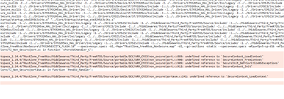

I am getting the error as below .
Please help me to resolve this issue.

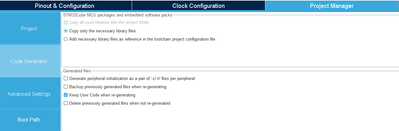

I already tried the approach listed in this thread Post ,but I was still facing the issue as listed in the post.
Also I am not able to select the "Copy all used libraries into the project folder"
Can you propose a link/Post where the mention problem is solved .

I am not able to select the "Copy all used libraries into the project folder" so without selecting I did all the steps suggested in the given Post .I am able to Build the project , But is that the right approach .
Can you please guide me on this.
