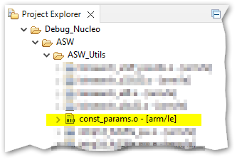

Yes the file exists albeit in sub folder.
This got me thinking that I need to qualify the object filename with a relative path:
.cal_data :
./ASW/ASW_Utils/const_params.o(.rodata)
} > FLASH
Now the linker completes its .elf output without error. However, the cal_data output section still does not appear.

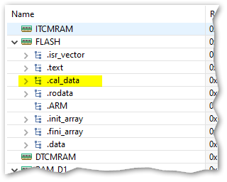

Fortunately this now triggers the correct result:

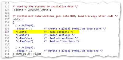

The implication is that only a wildcard for the input section is effective and indeed that is born out by experiment. For example, commenting out line 134 here does precisely nothing:
So this begs the question why the wildcard for the input section name is mandatory or, put another way, when would the line on 134 above be effective? I guess it's not critical, just curious.
