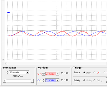

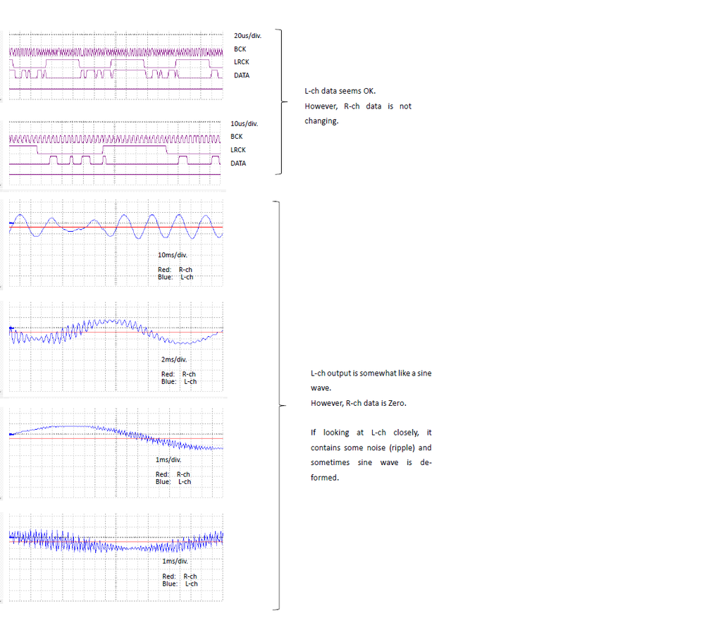

I wrote a simplest program (below) to send sine wave data to PCM5102A (DAC) via I2S.
However, I found only L-ch data is valid and R-ch has no data.
Analogue (DAC) output of L-ch is somewhat sine wave, but it is sometimes de-formed. And if I look it closer, I found some noise on the signal. (below captured screen shot)
I use HAL and STM32F401. And I2S settings are half-duplex master transmit (only).
Kindly enlighten me what is wrong with my program.

}Screen capture of USB scope.

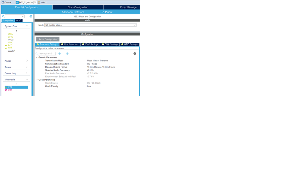

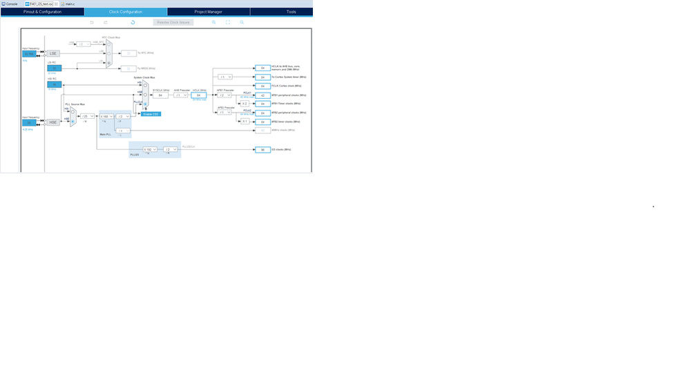

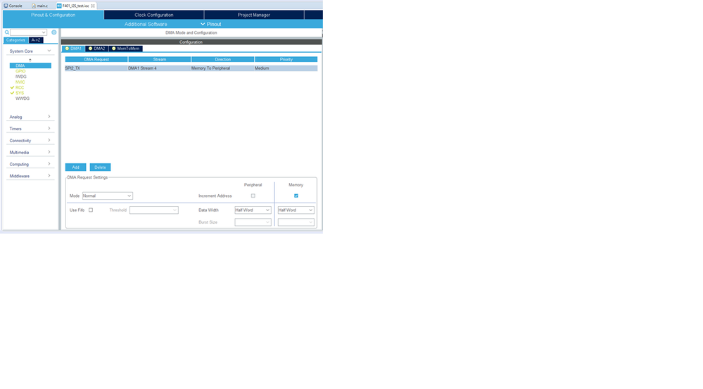

To share the result with the community, I put entire code and settings screen shots below. (How easy to use I2S with CubeMX!!)

Clock configuration
I2S configuration
DMA configuration
