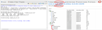

> I'm using STM32CubeIDE Version 2.0.0 and would like to get the size of all the object files in my build.
This is available with the default build settings.
After building, go to the Build Analyzer, refresh, then go to the Memory Details tab and you can see the size of each object.

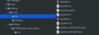

2025-12-20 12:00 PM
No, it's not. What I want to do is run arm-none-eabi-size on each of the compiled object files. Looking at the build directory, it seems the .o files are not being retained, so I need them to remain so I can get their individual sizes. I'm fluent in shell scripting; I need to know the current working directory for the post-build step and where the files are so I can size them.
2025-12-20 12:15 PM

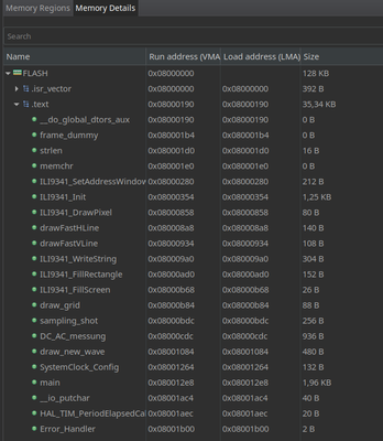

Ah, the files are in -> debug/.../src , see all "src" for core, drivers, middleware, third party, etc.
But afaik not very useful, as there is all of the libs etc., but the optimizer+linker takes only , whats used in target program. So this is more like a useless info about possible size.
What i showed , in "memory details" , is whats really used then.

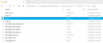

2025-12-20 12:26 PM
They're retained on my system. Default project settings.
The cwd is the build directory. Same directory as the ELF file. The *.o files are in subdirectories in the same structure as the *.c files in the project.
Should be very doable to find all *.o files in a script and do arm-none-eabi-size on them.
