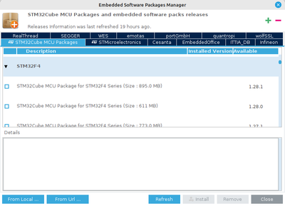

@AScha.3I go there and get the following list:
a) Is "STM32F4" the right selection in my case (Nucleo-F446RE)?
b) If so, there are plenty of packages to choose from, all with the same name (you can see the first 3 in the picture above), different size and different details. Should I choose a specific one or all of them?
@STTwo-32There's no "Updater Settings" under Help. I went to the FAQ pages you linked, where it says to git clone and replace "1234" with the right series of the cube package. What should I write for when using the Nucleo-F446RE? Must I clone it to a specific location?

Hello @FredBarkins
For the method of @AScha.3 , select the version 1.28.1 and click on install button it will ask you to login.
For the ‘1234’ you should replace them by F4 In your case.

2025-02-17 3:34 PM - edited 2025-02-17 3:52 PM
> I converged to this link .... Is "STM32F4" the right selection in my case (Nucleo-F446RE)?
Yes exactly this. Get the latest version unless you want other specific version.
> c) Should I download one of these:
Ah, this is a complicated moment. Versions that end by .0 (1.28.0) are major releases. You can get only this and it can be enough. Things that end by other digit (1.28.1) are called patches (updates) that are based on closest major release. If you want version 1.28.1, first install base package 1.28.0 then install the patch 1.28.1 OVER it.
To install, use the "Manage software packages" tool of CubeIDE or CubeMX. Click "From Local". This will install it to the right place - again unless you want other location.
