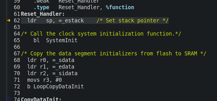

2025-02-22 11:58 PM
This solution doesn't seem to work for me. All MCUs enter reset loop when used with the gdb that comes with gdb-multiarch.
