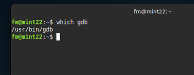

What does "which gdb" say ?
It should look somewhat like this:

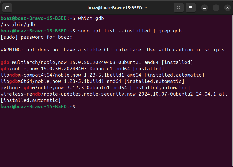

2025-11-23 9:16 AM
This is the output
2025-11-23 10:00 AM
