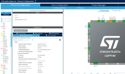

big surprise: when activating SAI on H7A3ZIT , no configuration possible : ...nothing to configure...
+ on IDE 1.18.0 , with newest Cube package: 1.12.1
+ on H743ZIT , looks as it should:
... V1.12.2 coming then ?
- or "manual setting needed ? on H7A3 it makes then: (ignoring the warning about SAI not correct set)

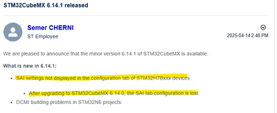

Hello @AScha.3 ;
The SAI tab configuration issue is fixed as mentioned in STM32CubeMx 6.14.1 released.
Could you please try to use the latest STM32CubeMX 6.14.1 version and/or STM32CubeIDE1.18.1 version and let me know if the issue is solved or not?

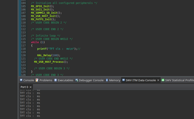

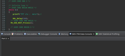

2025-03-28 3:33 AM - edited 2025-03-28 5:09 AM
Hi, @KDJEM.1 ,
similar ...but new. Or new old recovered, because on last Cube 1.11.2 :
it was ok, at least SAI :
--- but SWV not working here at all !
here sending on SWO in main loop - nothing comes to console, no profiling also:
btw on H743ZIT its working , profiling also.
ed with recent Cube/HAL v1.12.1 , after maybe 30 times (!!!!) click on start trace SWV, its working:
So this is the well known state of SWV on STM's IDE . fine.

2025-04-14 8:42 AM - edited 2025-04-14 8:43 AM
Hello @AScha.3 ;
Thank you.
Kaouthar
