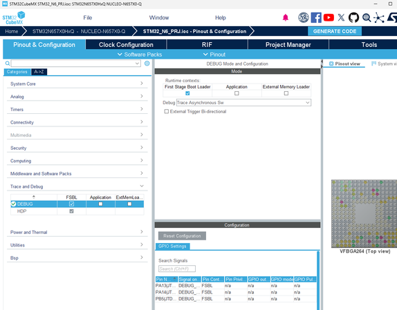

I would like to use SWV for debugging on the Nucleo-N657X0-Q board.
I first enabled SWV debugging and also change the CPU clock to 400 MHz.

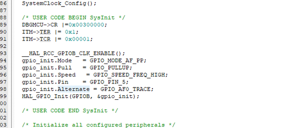

Then, I added some code to main.c (as reference here ).

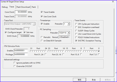

At the same time, I also set the core clock to 50 MHz in the TRACE configuration of Keil.
But i can't see any string in Debug Viewer.
Does anyone know what else I should check?
Thank's

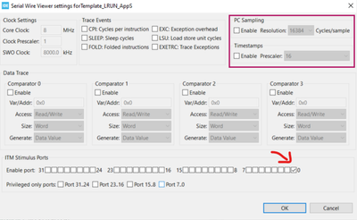

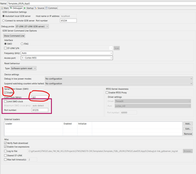

2025-06-20 7:00 AM - edited 2025-06-23 12:28 AM
Hello @bioak and welcome to the community;
Have you encountered the same issue while using the STM32CubeIDE toolchain?
I recommend you to look at this post and get inspired to check the settings:
I hope this help you.
Thank you.

2025-06-22 11:03 PM - edited 2025-06-22 11:04 PM
Hi KDJEM,
I made a silly mistake.
At first, I used CubeIDE, but I couldn’t see any messages in the Trace View window.
So I switched to Keil MDK to verify the output.
Now I can see the messages.
The reason I couldn’t see the printf messages in CubeIDE was that I hadn’t enabled Start Trace.
Thank you for your reply. I really appreciate it.
