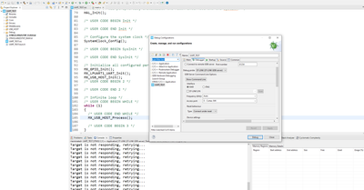

Well, there are several modes in which your STM32L496 can work, including the ultra-low power modes, in which access via SWD is only possible via hardware reset. If this has been set with the current programme, the STM32 will remain in this state until you programme it differently.
Nevertheless you can access the target by setting the following path (with STM32CubeIDE):
Run > Debug Configurations... > [make sure that your application on the left is selected] > tab Debugger > Reset behaviour: set Type = Connect under reset

I went to the above path and that option of
is already the set behavior.

I also tried to run the stmcube programmer and do an erase of the chip, but it won't stay connected. Is this to the low power state? And I looked at the path. you mentioned and it was already set to the state you mentioned when I was having the issuess
2025-02-27 7:28 PM
I switched workspaces and tried to make a uart program. I enabled a uart pin from the ioc file, it generated the code, and I tried to load it on the board. And I had the same issue with Target not responding. Not quite sure how my board got in this state. I can sometimes get it to load a program onto the board after cleaning a bunch of times, unplugging it and plugging it back in etc. This is really slowing down the process of developing. I tried to use the stm programmer to erase the chip, but the board won't stay connected. I also tried to go to the debug config and it seems the setting you told me to add is already set.
