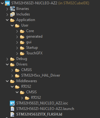

I created a project in TouchGFX Designer for the Nucleo-H563ZI dev kit as suggested by ST for projects that use TouchGFX. Once created I imported the existing project into STM32CubeIDE which was fine, however the project explorer in STM32CubeIDE does not show the .ioc file even though it exists in the actual project files.
I tried to copy a link to the .ioc into the CubeIDE project explorer but when I try to open it the IDE says it's not part of the project, however I can open it in CubeMX and generate files just fine. What am I missing?

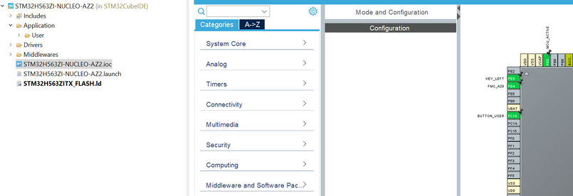

It is a naming issue. Rename the IOC file by replacing the underscore with hyphens. Then you should be able to drag the file onto the project and link it.
STM32H563ZI-NUCLEO-AZ2.ioc
Here you can see the IOC file opened after it was renamed to match the project name.
