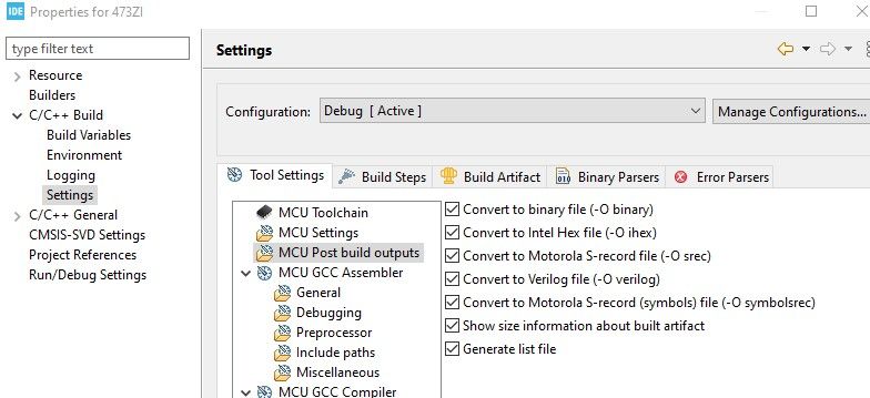

2021-03-09 5:37 AM
I've a strange problem with CubeIDE 1.6.0, there's no binary or hex file output even if the corresponding outputs are activated under MCU post build outputs. Any ideas what might be the issue there?
Regards

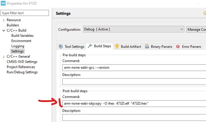

2021-03-10 8:59 AM
While they are pondering on yet another problem , here is a postbuild script to plug the hole.
For Linux _and_ Windows. Not tested on OSX.
-- pa

2021-03-22 12:57 PM
It appears that the MCU Post build outputs step is run only when Builder Type (on Builder tab in Properties->C/C++ Build) is External builder. When I set Builder Type to Internal builder, the MCU Post build outputs step is not run.
This appears to be a bug in STCubeIDE 1.6.0

2021-03-23 1:30 AM
Fact is STM32CubeIDE default is external builder not internal one.
I confirm if internal builder usage post build step leading to have following UI settings not active
But still possible if internal builder to rely by yourself on post build steps
Why are you moving to internal builder ???
