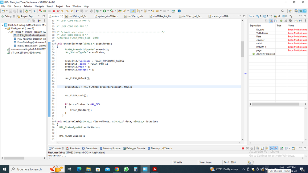

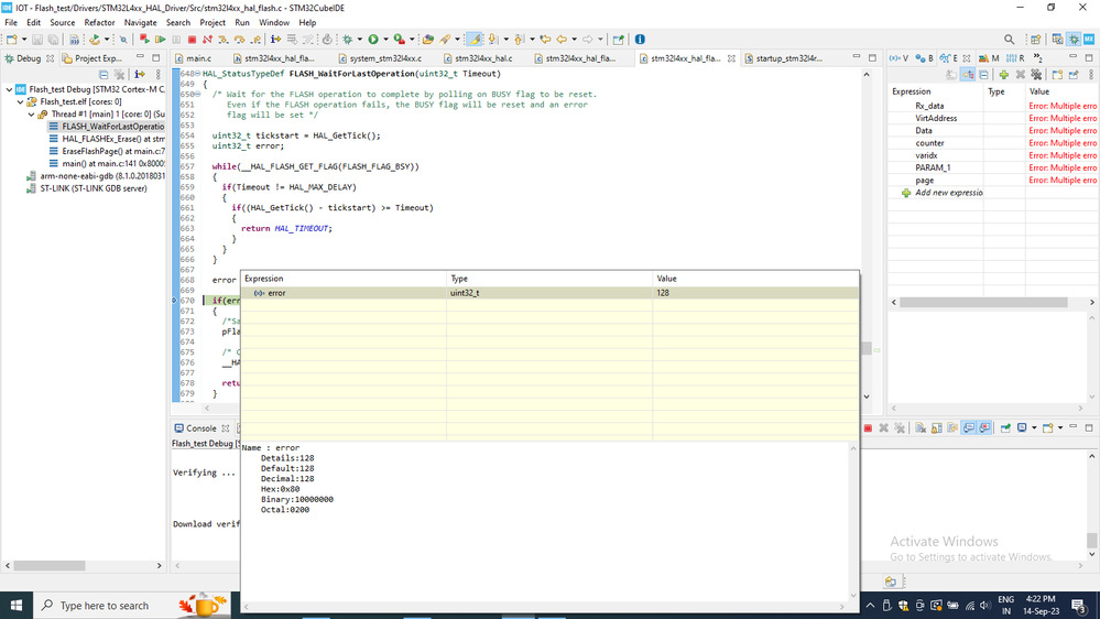

2023-09-14 4:02 AM
hello,
I have made mass erase to page erase and then also while erasing returns with an error=128.
I will attach snippet of that for reference.
