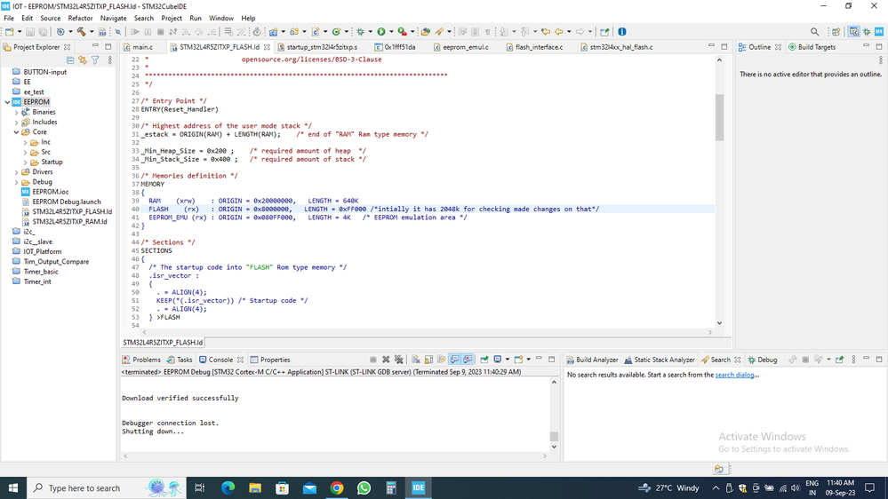

2023-09-08 11:15 PM
hello,
I have tried this shrink the FLASH but still facing same issue.
this way i have made changes is this correct or need to change, help me to debug this issue.
Thank you,

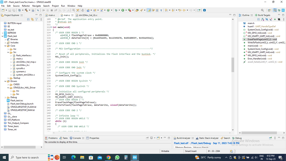

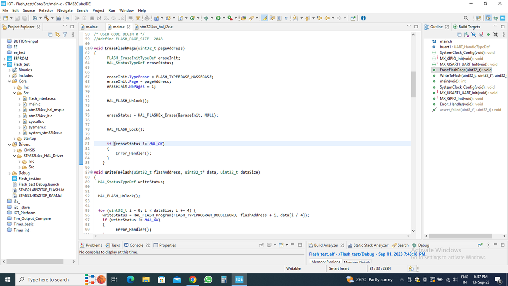

2023-09-13 6:20 AM
Yes, for simple example not for an eeprom emulation .
I have attached a snippet of that for reference, in this I'm trying write data to flash in that erasestatus it returns error.
2023-09-13 6:23 AM
2023-09-13 6:28 AM
You're erasing the entire flash in that example. You probably want type FLASH_TYPEERASE_PAGES. You're also sending what looks like an address as the page index.
Perhaps go off of a known working HAL example.
