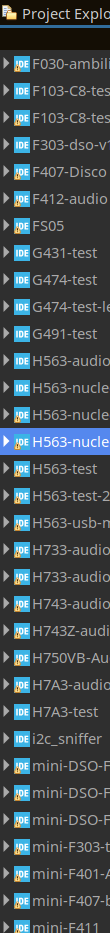

I started a new project 5/14 and it requires me to login using the myST button. For two days it refuses to connect. I am on a hardwired internet connection in a small two person company so there it no "IT" guy to check with.The advise given on this board does not change anything. It worked on a different project 5/13
I'm thinking I have to re-install CUBE ??? That shouldn't be necessary everytime you change targets.
