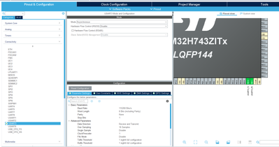

Well, you don't see anything via Putty or Teraterm because you parameterised USART3 correctly (asynch, 115200 Bits/s, etc) but accidentally stumbled over the pin multiplexing. In the STM32H743, PB11/PB10 is unfortunately selected as the default for USART3 RX/TX, but in the NUCLEO-H743ZI (MB1364) PD9/PD8 are connected to T_VCP_RX/_TX via SB12/SB19. So the USART3 permanently writes the data to the TX channel - but you have checked on a different TV channel... :smiling_face_with_smiling_eyes:
Solution: simply remap the alternative pins for USART3_RX/TX in the CubeMX overview of the STM32H743ZITx as described in UM1718, section 4.45:
To manually remap a function to another pin, follow the sequence below:
...i.e. drag them one after the other to PD9/PD8.

So first i make a new project in stm32cubemx, i choose my board, then i go to connectivity and i configure it like in the photo:

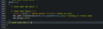

Then i generate code, i write between /* USER CODE BEGIN 3 */ and /* USER CODE END 3 */ the next lines:
Then i build my project, open tera term clicking on new connection with the same baud as in the upper photo here and nothing appears in the screen...

I have thrown your three lines of code into an otherwise empty project for a NUCLEO-F767ZI as a test - it works, both with Teraterm and other terminal programs if you have selected the correct port (STMicreoelectronics STLink Virtual COM Port):
/* USER CODE BEGIN WHILE */
while (1)
/* USER CODE END WHILE */
uint8_t Test[] = "Hello World!\r\n"; // should be placed in the block PV
HAL_UART_Transmit(&huart3, Test, sizeof(Test)-1, 10);
HAL_GPIO_TogglePin(LD1_GPIO_Port, LD1_Pin); // make the while loop visible via LD1
HAL_Delay(1000);
