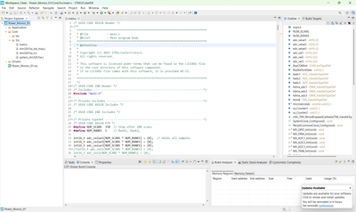

CubeMX Auto Code generation created STM32CubeIDE directory inside the project directory. I had to deleted it.
I got the project displayed normally. But it does not build project when clicking "Project -> Build Project"- Nothing happened.
2025-07-11 7:47 PM
I see that the Project has an "!" on the icon and on the IOC file. How did you import the project? Did you use Existing Project into Workspace?
2025-07-11 8:05 PM
"Did you use Existing Project into Workspace?" - Yes. I did.
The build project does not work.

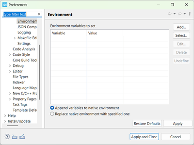

Also I found
Window → Properties → C/C++ Build
Environment Variables configuration in STM32CubeIDE appears empty (The files are exist in ST directory)
How to fix it?
