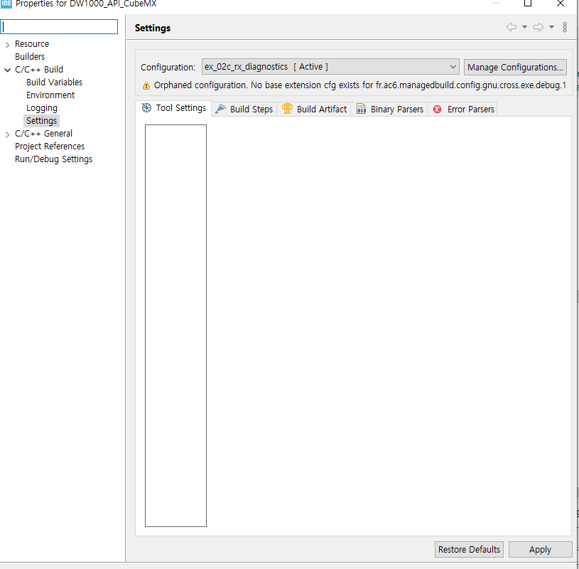

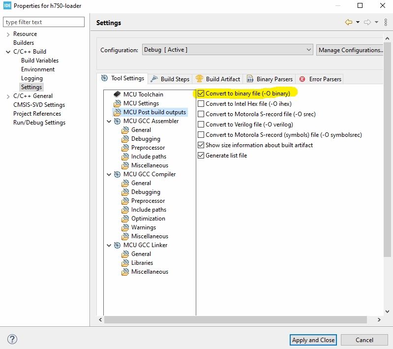

Check Project → Properties → C/C++ Build → Settings → Tool Settings → MCU Post build outputs if "Convert to binary file" is checked

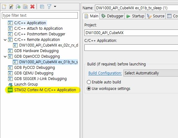

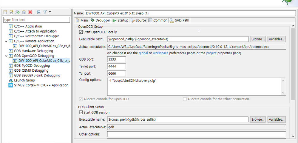

By default, if you double-click on "STM32 Cortex-M C/C++ application" on your screenshot it will create debug configuration which works (at least with ST-Link + SWDIO). Try to double-click on "STM32 Cortex-M C/C++ application", last in your list, with a blue icon, and open debug tab, you can change it to openOCD:

Try to create new debug configuration by double-clicking "STM32 Cortex-M C/C++ application" and press "Debug" button.

I checking my C/C++ build setting but, i can't see category in the Tool setting menu.
Maybe some wrong my tool setting. how can i fix? sorry i'm beginner this field.

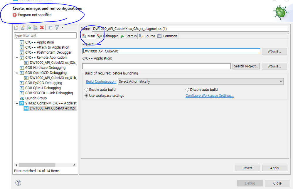

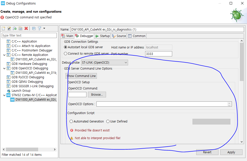

And created the debug configuration about "STM32 Cortex-M C/C++ aplication", By the way, there were two problems.
First. Main tap have some issue the "Program not specified" error.
Second. how can i change the open ocd? Now my setting is "ST-LINK (ST-LINK GDB server)" when i change the "ST-LINK (OpenOCD)" there's no setting.

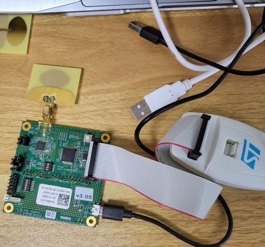

How is the board physically connected to your PC? You need a programmer in order to program it. The EVK1000 does not have a built-in programmer.
2021-10-15 4:47 PM
Sorry late. My test board consist of USB and ST-LINK/V2. ST-LINK and USB connected PC. below uploaded picture.

How did you create your project in cubeIde? For some reason your project toolchain is not configured properly. Maybe project was created or imported from older Ide version and something is broken now. In this case installing older Ide version would be fastest way to make things work. Problem with debug in current version may be investigated later

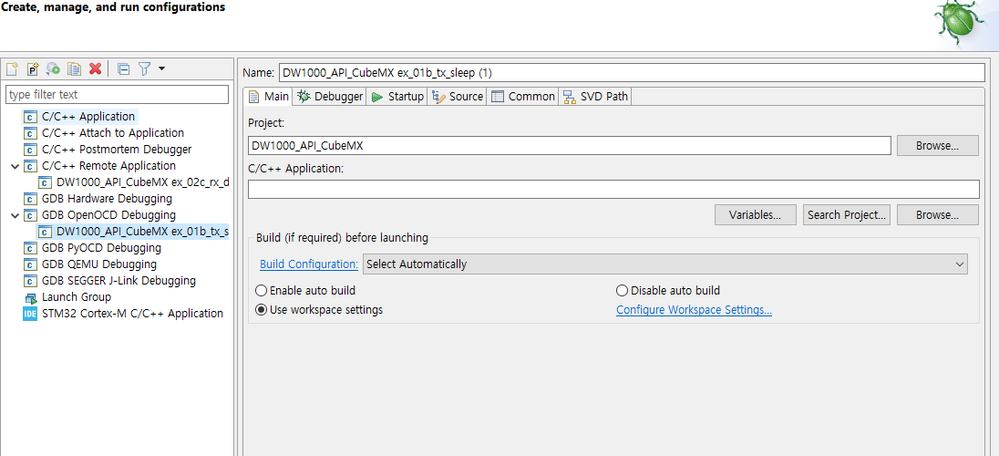

I may have found a solution. I was working on my new gesture recognition module project for Arduino and other I2C capable boards, and my STM32H7 bootloader project refused to debug after I copied some files. I am not sure what exactly caused this, but what was missing is "C/C++ Application:" path to my "Debug/h7-loader-25mhz-pa9pa10.elf".
On your screenshots "C/C++ Application:" is blank too. Try to do this to fix it:
1 - manually enter path to ELF file in "C/C++ Application:"
or
2 - go to "Common tab", check "display in favorites menu" for "Run". Close all dialogs. After pressing debug hotkey/menu, STM32Cube Ide pop-ups message and asks which .ELF file to use.
I hope this solves debug button grayed out / error problem.
