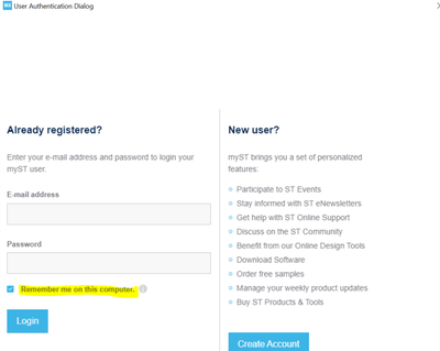

2025-04-02 7:41 AM
In fact, if users save their ST login information, folders into Profile are not being deleted after closing.
Folders under "Profile" should be automatically deleted after closing STM32CubeMX standalone or STM32CubeIDE.
This problem has been reported to the development team, and I'll let you know once it's fixed.
You can delete manually the "Profile" and not the JxBrowser folder itself.
