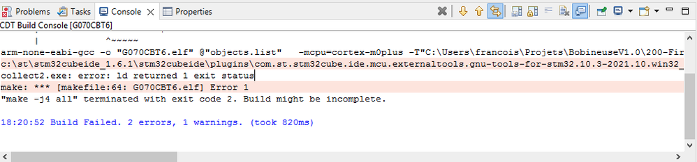

I always use "extern" to define global variable and with the last version of stm32cubeide, it's working wel for the L562 target but i've a problem with the g070 device with the folowing error(s). What's wrong?
"arm-none-eabi-gcc "../Core/Src/stm32g0xx_it.c" -mcpu=cortex-m0plus -std=gnu11 -g3 -DDEBUG -DUSE_HAL_DRIVER -DSTM32G070xx -c -I../Core/Inc -I../Drivers/STM32G0xx_HAL_Driver/Inc -I../Drivers/STM32G0xx_HAL_Driver/Inc/Legacy -I../Drivers/CMSIS/Device/ST/STM32G0xx/Include -I../Drivers/CMSIS/Include -O0 -ffunction-sections -fdata-sections -Wall -fstack-usage -MMD -MP -MF"Core/Src/stm32g0xx_it.d" -MT"Core/Src/stm32g0xx_it.o" --specs=nano.specs -mfloat-abi=soft -mthumb -o "Core/Src/stm32g0xx_it.o"
../Core/Src/stm32g0xx_it.c:60:12: warning: 'status' initialized and declared 'extern'
60 | extern int status = 0;
arm-none-eabi-gcc -o "G070CBT6.elf" @"objects.list" -mcpu=cortex-m0plus -T"C:\Users\francois\Projets\BobineuseV1.0\200-Firmware\G070CBT6\STM32G070CBTX_FLASH.ld" --specs=nosys.specs -Wl,-Map="G070CBT6.map" -Wl,--gc-sections -static --specs=nano.specs -mfloat-abi=soft -mthumb -Wl,--start-group -lc -lm -Wl,--end-group
c:\st\stm32cubeide_1.6.1\stm32cubeide\plugins\com.st.stm32cube.ide.mcu.externaltools.gnu-tools-for-stm32.10.3-2021.10.win32_1.0.0.202111181127\tools\arm-none-eabi\bin\ld.exe: ./Core/Src/stm32g0xx_it.o:C:/Users/francois/Projets/BobineuseV1.0/200-Firmware/G070CBT6/Debug/../Core/Src/stm32g0xx_it.c:60: multiple definition of `status'; ./Core/Src/main.o:C:/Users/francois/Projets/BobineuseV1.0/200-Firmware/G070CBT6/Debug/../Core/Src/main.c:155: first defined here
collect2.exe: error: ld returned 1 exit status
make: *** [makefile:64: G070CBT6.elf] Error 1
"make -j4 all" terminated with exit code 2. Build might be incomplete."

Hi there,
i guess you have "extern int status = 0;" in the header file? If thats the case you should not initialized but declare the variable in the header file. Initializiation should be done in the according source file. eg.,
in the header file control.h:
extern int status;
and in the source file control.c
int status = 0;
if you then include the header file in a different source file you can use the global variable status there as well. I hope i could help, if not dont hessitate to come back. As a side note, if you declare a global variable with a scope beyond one source file, it can be a great help to name the variable in a way to indicate where the variable is from, in my case control_status would be better then just status, therefore i would know that the variable control_status is inside the control source file. Makes analyzing your code way easier, espacially if its not yourself.

Solved!
The problem was solved with upgrading to the last version of the HAL firmware package.
