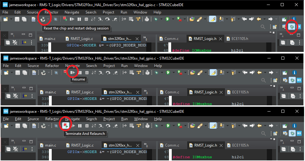

2022-10-25 2:10 PM
When you are in debug mode these buttons (circled in red in attached screen capture) will do what you need. Button on upper right corner puts you in debug mode.

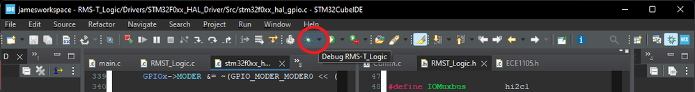

2022-10-25 2:15 PM
This button starts the debugging of your code. In below screen shot, it will start debugging the project "RMS-T_Logic"
