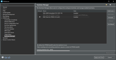

I have installed the newest STM32CubeIDE (14.1) and tried to load an example project. Unfortunately, no builder is available. The Project Properties under Builders is just empty.
Under Preferences the Toolchain Manager GNU Tools for STM32 (11.3.rel1) is installed but not set to default. However even setting it to default and restarting the CubeIDE does not help.
Please note that the Computer that should run the IDE has no internet access. The Toolchain Manger ties to connect to the ST repository to update or maybe find the specific tooling for the STM32L5.
I am wondering if a current manual to install CubeIDE offline exists or if I would need to download the specific toolchain for the STM32L5 from somewhere.

I suggest that you install the toolchain GCC12.3. You go to Window > Preferences > STM32CubeIDE > Toolchain manager.
It is better to have access to the internet in order to install the appropriate packages. You will be asked to connect to your STMicroelectronics account to download the packages.
