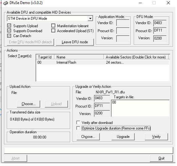

4) include created static library into cube ide project. code compiled. HEX to DFU file created.
5)using st link bootloader HEX file loaded into hardware. After that dfu file is loaded using Dfuse software.
As per bootloader after power on, dfu mode stays for 10 sec within that time dfu file should be loaded into the hardware.
When library added dfu file is loaded into the HW device does not come out of DFU mode. it stays there. If manually DFU mode is leaved that time DfuSe gets hang.
Need your help... If someone had similar type of issue kindly post the solution this...
Is my library creation process has some issue? Is there another way to add library into the project? or project migrated from the Atollic to stm32 cube IDE does not work for library?
