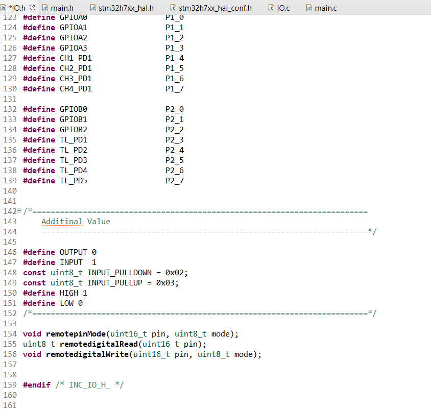

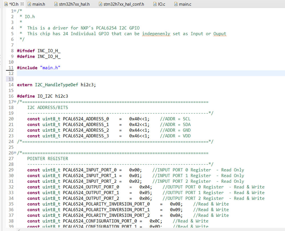

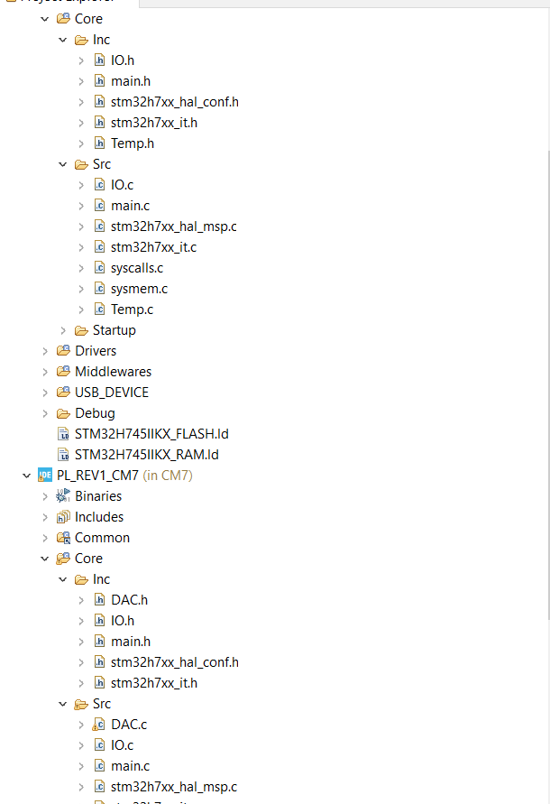

When I try to add IO.h in IO.c its working fime but when I try to add this file in main.c or temp.c it throw errors.I am sharing the the snap of my files, i am unable to understand why its erroe comes.
2022-03-21 9:26 PM
>> i am unable to understand why its error
It SPECIFICALLY tells you it's those variables you're defining as const.
Put those in IO.C, or use #define's or enum's
