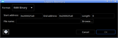

2024-02-19 2:38 PM - edited 2024-02-19 2:40 PM
Hmmm...
in memory browser -> export i get this :

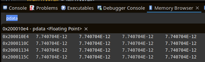

and the data - if default (the three vertical dots)
is set to floating point - :
2024-02-19 2:57 PM
Thanks. Yes, that presents it as floating point in the Memory Browser. But if you export from there to a file, like your first picture, it's in native hex format. Whereas I'm trying to export floating point data into floating point format in a a file. Not a huge issue, just have to write a utility to translate the forced hex in the exported file, into floating point. Odd, though, since the IDE already knows the floating point format, that it can't just write that to a file (and instead forces hex bytes).
