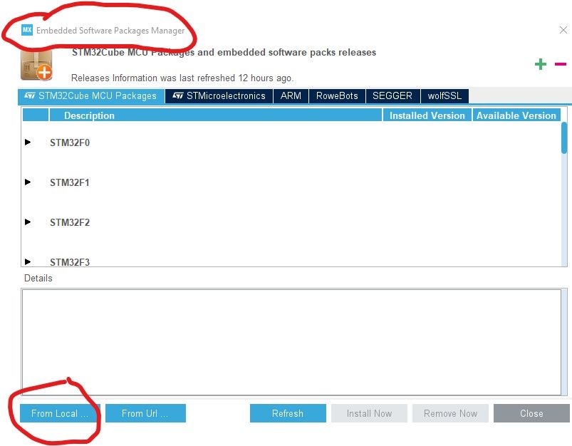

2021-05-24 11:07 PM
Best is download from www.st.com.
If L0 serie https://www.st.com/en/embedded-software/stm32cubel0.html
if F4 serie https://www.st.com/en/embedded-software/stm32cubef4.html
etc. ...
Then rely on Help > Manage Embedded Software Packages

2021-05-25 12:01 AM
Be aware firmware pack minor releases are patches only. Means if having 1.8.0 on board and need to get 1.8.3 you have to install 1.8.3 on top of 1.8.0.
Handmade process is obvious let's unzip 1.8.3 delivery with same root folder than your 1.8.0 and accept to override all conflicting files (<=> patch)
Cube ecosystem doesn't care about folder naming but relies on package.xml file at firmware package root
