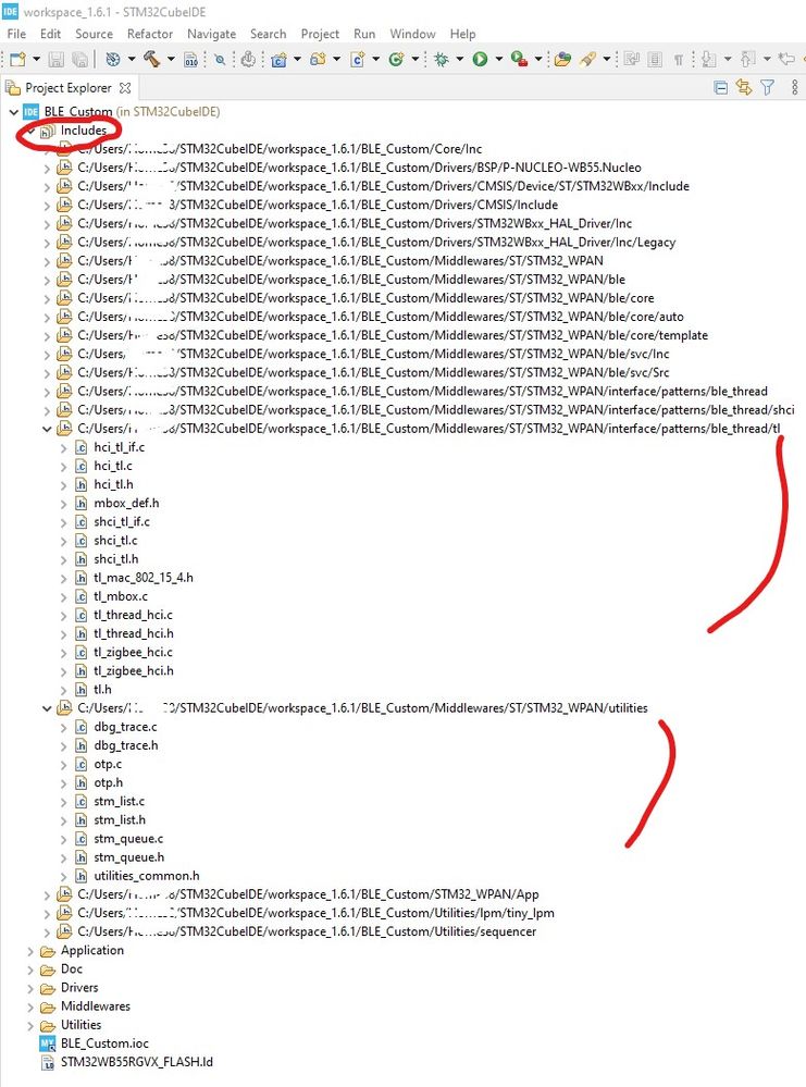

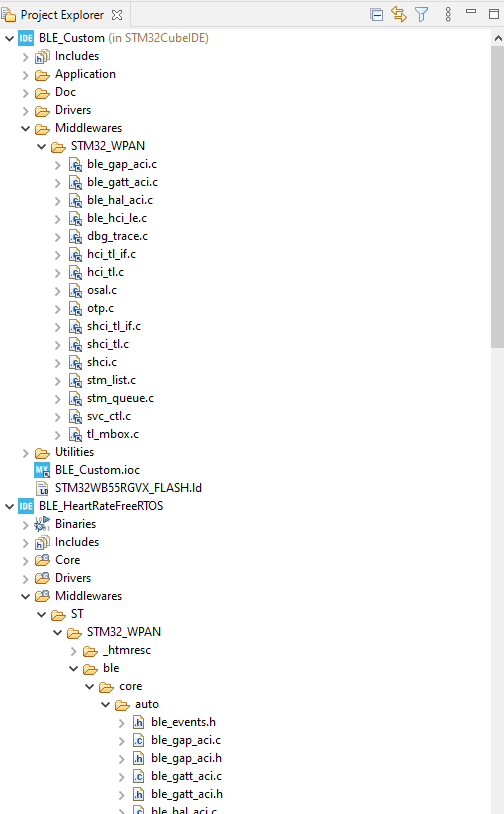

Image attached.
The NO RTOS project shows all BLE files 'togehter' , without .h files
The RTOS project keeps them in the original file structure.
How can I see the .h files in IDE?
Is there a way to sync then to same view?

If I try the same with the STM32Cube_FW_WB_V1.11.1 and the board: P-NUCLEO-WB55.Nucleo, then I do not get the same result for the BLE_HeartRateFreeRTOS example. For me I do not get any h-files. And all files are linked as indicated by the small "arrow decorator" in the bottom-right corner of each file icon.
In general h-files are not listed as part of the example project in the .project-files. Therefore they are not visible in the project tree structure. h-file directories are typically only setup as include directories to the compiler. So, to me, this is "almost" working as expected...

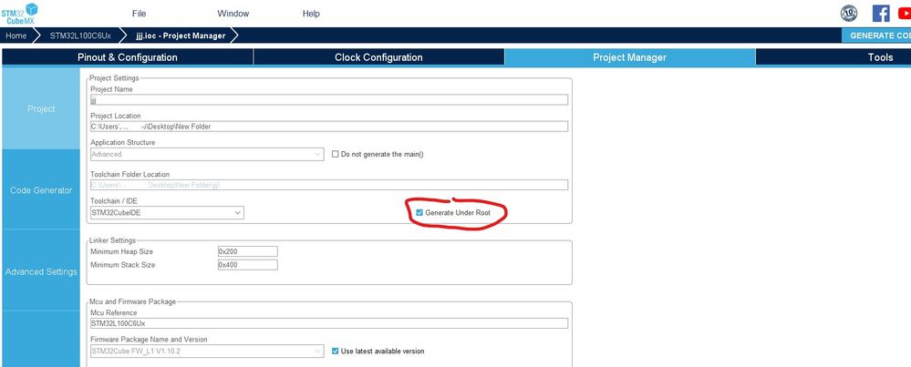

I started the process in the CubeMx exmaple, later, generating code for IDE.
It will produce a different view in the IDE.
2021-05-24 10:52 AM
Most probably you have to take care to project root mode you're relying on.
STM32Cube example are so called 'non under root' (because sources are shared across multiple IDEs (IAR, Keil, STM32CubeIDE, ..))
If creating a project from scratch relying on STM32CubeMX you can select between 'non under root' or 'under root' mode
If creating a project from scratch relying on STM32CubeIDE no choice your project will be 'under root'
As 'under root' and 'non under root' structure are not same you cannot mix them. Initiating a project relying on one mode is final choice.
