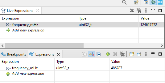

2023-11-09 5:28 AM
I'm occasionally experiencing the same problem after some time of debugging session, where the program is interrupted, run in steps and resumed continuously. I captured the the following image when the execution was suspendend/paused; it shows that the expression variable is different from the live expression variable. When the program resumes, the live variable gets insane unstable. Stopping the debug session or restarting the ide doesn't fix the problem.
The magic fix is achieved by disconnecting the USB cable from the ST-LINK (ST-LINK/V2 ISOL with latest firmware in my case) and restating the debug session.
I hope this help.
