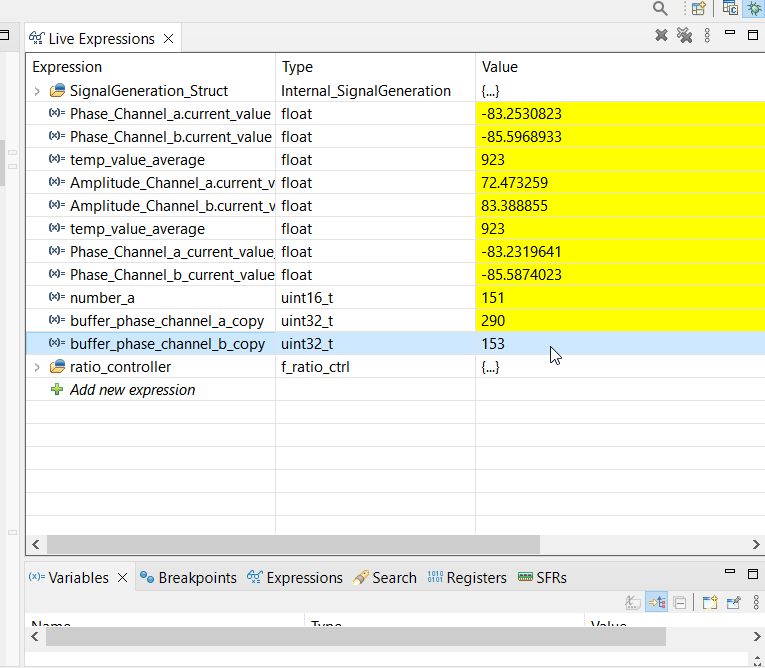

Beginning:

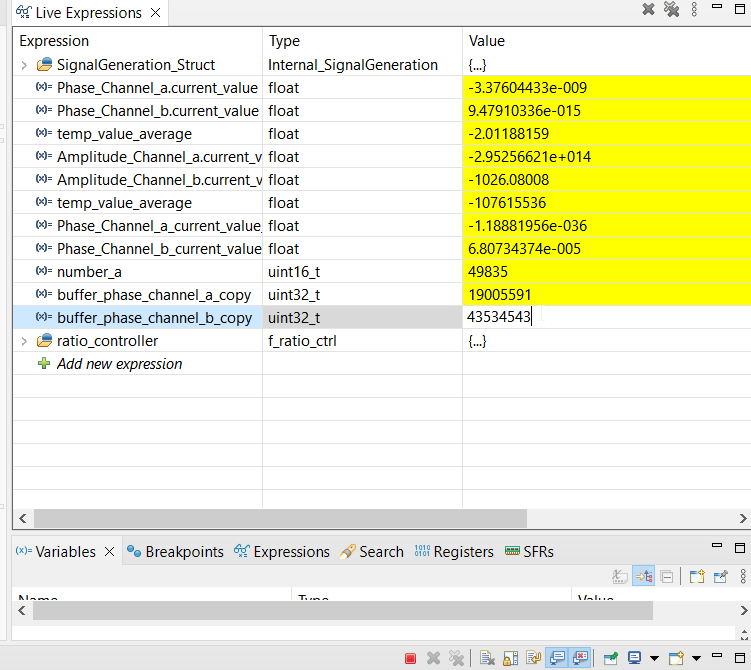

After writing a number:

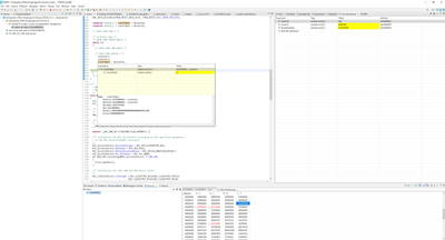

@Ghofrane GSOURI wrote:This issue has been already reported to our STM32CubeIDE development team in this ticket 175214
See also ticket ID 168019:
