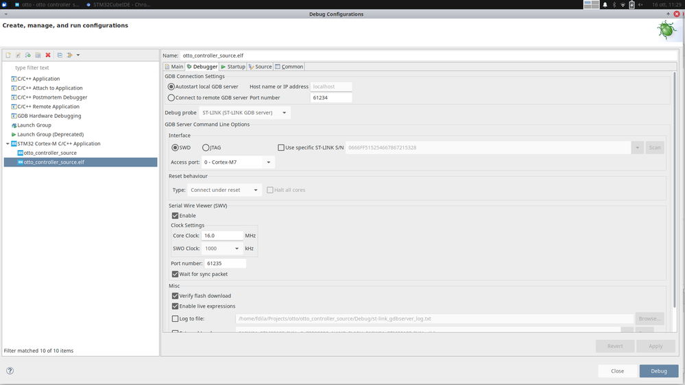

I'm currently using STM32CubeIDE (version 1.1.0) to write and debug a c++ program on a NUCLEO F767ZI.
I'm trying to use the "Live Expression" but it either doesn't update the variables live (it updates them when I pause the program") or it says "Failed to evaluate expression".
What is the correct way to configure the debugger?
My current configuration is:

Update: it works with global variables. Is this the right behaviour or is this a bug? Will tracing local variables be available in the future?
