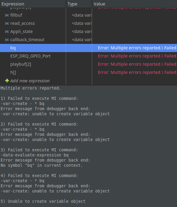

This only happens to new variables added to my C code after Oct 2022. "Old" variables still work fine. When I add failing variables to the "Expression" tab I get "Error: Multiple errors reported". Reported are:
Multiple errors reported.
1) Failed to execute MI command:
-var-create - * HelloWorld
Error message from debugger back end:
-var-create: unable to create variable object
2) Unable to create variable object
3) Failed to execute MI command:
-data-evaluate-expression HelloWorld
No symbol "HelloWorld" in current context.
4) Failed to execute MI command:
Does anyone have an idea? Looks like the debugger is not getting resources from Windows. I use 1.10.1 Build 12716_20220707_0928 (UTC)

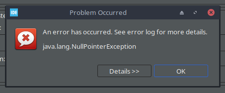

i have similar problem: in debug / beakpoint no more variables shown at all ! shows declaration as if its in C editor mode. live expressions also no more working...just error msg.
see:
and blue -> detail:
is still same, when on OpenOCD instead of ST-LINK GDB-server.

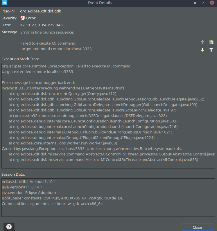

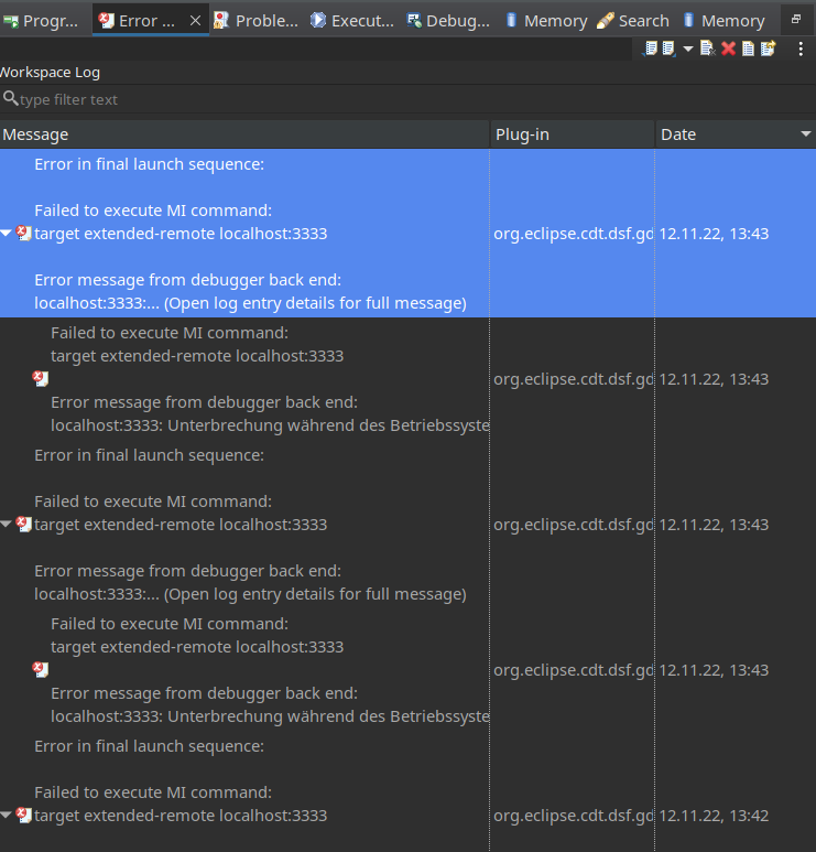

problem maybe here:
or here, the root of all evil ?

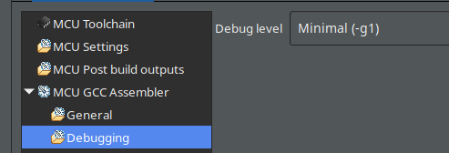

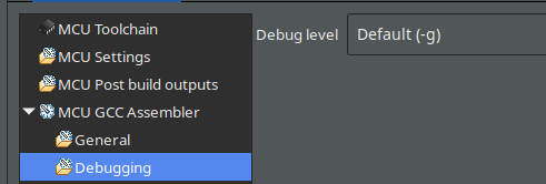

for a speed test, i changed in a test project many optimizer and other setting, just also debug:
for some (idiot) reason, seems all projects got changed settings.... so turn to standard:
now variables shown in debug session again and start at "main" again.
