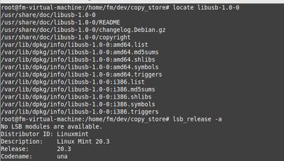

And checking the first package in my VM, it is present :
I suppose you did at least one apt-get update / apt-get upgrade / apt-get dist-upgrade cycle, didn't you ?
