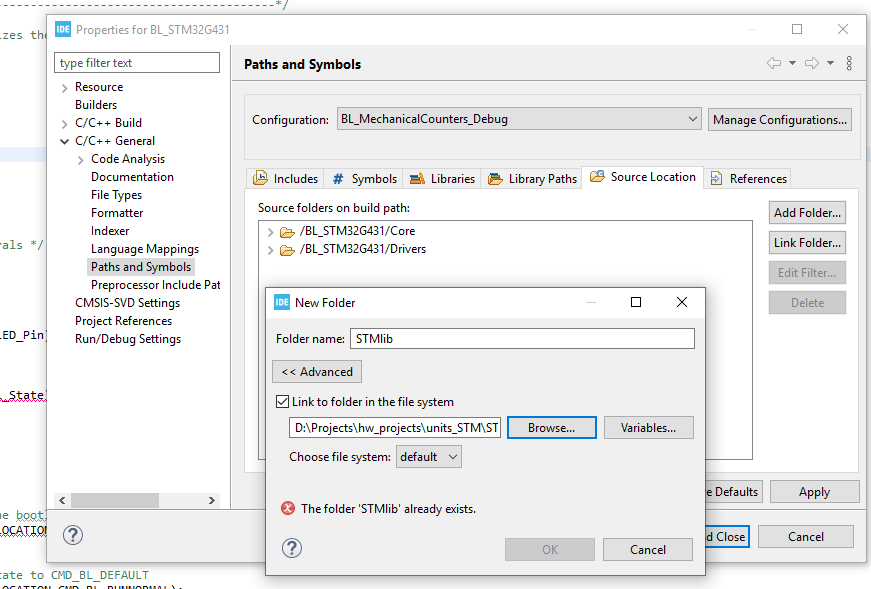

i need to delete and link the STMLib folder each time when i switch my configuration.
When i try to do this for all configurations it shows me that's not possible?
when i select Debug and Release seperatly and try to add the link, it also refuse to do this because the map is already added to the project.
How can i use this link in all my configuration?

You can drag an existing folder in the Project Explorer View into your project tree. On mouse release you are asked if you want to make a link or a deep copy.

You cannot have different linked folders per configuration.
Because, configurations belong to CDT but linked folders are a 'core' feature of Eclipse which does not know about configurations.

none of the above advices worked as expected.
Are there other ways to include library files? I just want to include .c and .h files from an external library folder in release and debug configuration.
