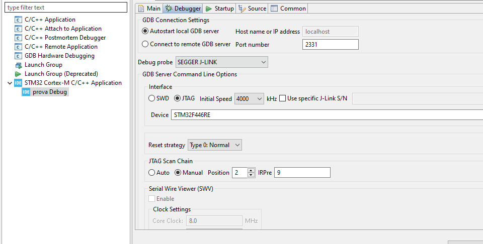

When I try to set the Manual search in the debugger configuration I get always this error:
ERROR: Expected an digit (0-9) after option "-JTAGConf".
GDB Server will close.
Command line error. Please check command line parameters and options.
Settings: J link Segger
The Position and IRPre are both correct. When I use the J-link Commander it works.
I tried the 1.10 and 1.4.2 Cubeide
Someone has any suggestion?
Thank you
