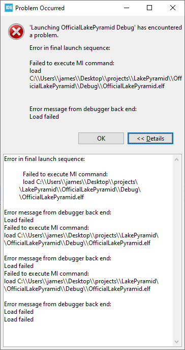

Restoring target state and closing J-Link connection...At the same rate, if I use an st-link programmer device I get this output to the console:
STMicroelectronics ST-LINK GDB server. Version 5.5.0
Copyright (c) 2019, STMicroelectronics. All rights reserved.
Starting server with the following options:
Persistent Mode : Disabled
Logging Level : 1
Listen Port Number : 61234
Status Refresh Delay : 15s
Verbose Mode : Disabled
SWD Debug : Enabled
InitWhile : Enabled
Waiting for debugger connection...
Debugger connected
Debugger connection lost.
Shutting down...
and this popup dialog:
If you look at the J-Trace log, clearly the verification of the downloaded bytes is failing, why is STM32CubeIDE telling the J-Trace to write to address 0x00008000? It looks like this address has been shifted right 3. The normal programming address is 0x08000000. Super strange and I have no idea how to fix this problem. In total this has probably caused me 2 weeks of development work dealing with it on and off, losing work as I am forced to revert to older code bases to get away from the issue (sometimes even this doesn't help);
