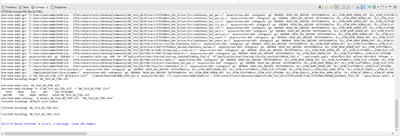

When trying to generate the project from the `.ioc` file you've sent I get the following:
15:03:31 **** Build of configuration Debug for project N6_Test_07_from_Mahmoud_config_FSBL ****
make -j8 all
arm-none-eabi-gcc "../X-CUBE-AI/App/app_x-cube-ai.c" -mcpu=cortex-m55 -std=gnu11 -g3 -DDEBUG -DUSE_HAL_DRIVER -DSTM32N657xx -DUSE_NUCLEO_64 -c -I../Core/Inc -I../X-CUBE-AI/App -I../X-CUBE-AI -I../../Drivers/STM32N6xx_HAL_Driver/Inc -I../../Drivers/CMSIS/Device/ST/STM32N6xx/Include -I../../Drivers/STM32N6xx_HAL_Driver/Inc/Legacy -I../../Drivers/BSP/STM32N6xx_Nucleo -I../../Drivers/CMSIS/Include -O0 -ffunction-sections -fdata-sections -Wall -fstack-usage -fcyclomatic-complexity -mcmse -MMD -MP -MF"X-CUBE-AI/App/app_x-cube-ai.d" -MT"X-CUBE-AI/App/app_x-cube-ai.o" --specs=nano.specs -mfpu=fpv5-d16 -mfloat-abi=hard -mthumb -o "X-CUBE-AI/App/app_x-cube-ai.o"
arm-none-eabi-gcc "/work/PSEE/stm32_2/N6_Test_07_from_Mahmoud_config/Drivers/STM32N6xx_HAL_Driver/Src/stm32n6xx_hal.c" -mcpu=cortex-m55 -std=gnu11 -g3 -DDEBUG -DUSE_HAL_DRIVER -DSTM32N657xx -DUSE_NUCLEO_64 -c -I../Core/Inc -I../X-CUBE-AI/App -I../X-CUBE-AI -I../../Drivers/STM32N6xx_HAL_Driver/Inc -I../../Drivers/CMSIS/Device/ST/STM32N6xx/Include -I../../Drivers/STM32N6xx_HAL_Driver/Inc/Legacy -I../../Drivers/BSP/STM32N6xx_Nucleo -I../../Drivers/CMSIS/Include -O0 -ffunction-sections -fdata-sections -Wall -fstack-usage -fcyclomatic-complexity -mcmse -MMD -MP -MF"Drivers/STM32N6xx_HAL_Driver/stm32n6xx_hal.d" -MT"Drivers/STM32N6xx_HAL_Driver/stm32n6xx_hal.o" --specs=nano.specs -mfpu=fpv5-d16 -mfloat-abi=hard -mthumb -o "Drivers/STM32N6xx_HAL_Driver/stm32n6xx_hal.o"
arm-none-eabi-gcc "/work/PSEE/stm32_2/N6_Test_07_from_Mahmoud_config/Drivers/STM32N6xx_HAL_Driver/Src/stm32n6xx_hal_cacheaxi.c" -mcpu=cortex-m55 -std=gnu11 -g3 -DDEBUG -DUSE_HAL_DRIVER -DSTM32N657xx -DUSE_NUCLEO_64 -c -I../Core/Inc -I../X-CUBE-AI/App -I../X-CUBE-AI -I../../Drivers/STM32N6xx_HAL_Driver/Inc -I../../Drivers/CMSIS/Device/ST/STM32N6xx/Include -I../../Drivers/STM32N6xx_HAL_Driver/Inc/Legacy -I../../Drivers/BSP/STM32N6xx_Nucleo -I../../Drivers/CMSIS/Include -O0 -ffunction-sections -fdata-sections -Wall -fstack-usage -fcyclomatic-complexity -mcmse -MMD -MP -MF"Drivers/STM32N6xx_HAL_Driver/stm32n6xx_hal_cacheaxi.d" -MT"Drivers/STM32N6xx_HAL_Driver/stm32n6xx_hal_cacheaxi.o" --specs=nano.specs -mfpu=fpv5-d16 -mfloat-abi=hard -mthumb -o "Drivers/STM32N6xx_HAL_Driver/stm32n6xx_hal_cacheaxi.o"
arm-none-eabi-gcc "/work/PSEE/stm32_2/N6_Test_07_from_Mahmoud_config/Drivers/STM32N6xx_HAL_Driver/Src/stm32n6xx_hal_cortex.c" -mcpu=cortex-m55 -std=gnu11 -g3 -DDEBUG -DUSE_HAL_DRIVER -DSTM32N657xx -DUSE_NUCLEO_64 -c -I../Core/Inc -I../X-CUBE-AI/App -I../X-CUBE-AI -I../../Drivers/STM32N6xx_HAL_Driver/Inc -I../../Drivers/CMSIS/Device/ST/STM32N6xx/Include -I../../Drivers/STM32N6xx_HAL_Driver/Inc/Legacy -I../../Drivers/BSP/STM32N6xx_Nucleo -I../../Drivers/CMSIS/Include -O0 -ffunction-sections -fdata-sections -Wall -fstack-usage -fcyclomatic-complexity -mcmse -MMD -MP -MF"Drivers/STM32N6xx_HAL_Driver/stm32n6xx_hal_cortex.d" -MT"Drivers/STM32N6xx_HAL_Driver/stm32n6xx_hal_cortex.o" --specs=nano.specs -mfpu=fpv5-d16 -mfloat-abi=hard -mthumb -o "Drivers/STM32N6xx_HAL_Driver/stm32n6xx_hal_cortex.o"
arm-none-eabi-gcc "/work/PSEE/stm32_2/N6_Test_07_from_Mahmoud_config/Drivers/STM32N6xx_HAL_Driver/Src/stm32n6xx_hal_dma.c" -mcpu=cortex-m55 -std=gnu11 -g3 -DDEBUG -DUSE_HAL_DRIVER -DSTM32N657xx -DUSE_NUCLEO_64 -c -I../Core/Inc -I../X-CUBE-AI/App -I../X-CUBE-AI -I../../Drivers/STM32N6xx_HAL_Driver/Inc -I../../Drivers/CMSIS/Device/ST/STM32N6xx/Include -I../../Drivers/STM32N6xx_HAL_Driver/Inc/Legacy -I../../Drivers/BSP/STM32N6xx_Nucleo -I../../Drivers/CMSIS/Include -O0 -ffunction-sections -fdata-sections -Wall -fstack-usage -fcyclomatic-complexity -mcmse -MMD -MP -MF"Drivers/STM32N6xx_HAL_Driver/stm32n6xx_hal_dma.d" -MT"Drivers/STM32N6xx_HAL_Driver/stm32n6xx_hal_dma.o" --specs=nano.specs -mfpu=fpv5-d16 -mfloat-abi=hard -mthumb -o "Drivers/STM32N6xx_HAL_Driver/stm32n6xx_hal_dma.o"
arm-none-eabi-gcc "/work/PSEE/stm32_2/N6_Test_07_from_Mahmoud_config/Drivers/STM32N6xx_HAL_Driver/Src/stm32n6xx_hal_dma_ex.c" -mcpu=cortex-m55 -std=gnu11 -g3 -DDEBUG -DUSE_HAL_DRIVER -DSTM32N657xx -DUSE_NUCLEO_64 -c -I../Core/Inc -I../X-CUBE-AI/App -I../X-CUBE-AI -I../../Drivers/STM32N6xx_HAL_Driver/Inc -I../../Drivers/CMSIS/Device/ST/STM32N6xx/Include -I../../Drivers/STM32N6xx_HAL_Driver/Inc/Legacy -I../../Drivers/BSP/STM32N6xx_Nucleo -I../../Drivers/CMSIS/Include -O0 -ffunction-sections -fdata-sections -Wall -fstack-usage -fcyclomatic-complexity -mcmse -MMD -MP -MF"Drivers/STM32N6xx_HAL_Driver/stm32n6xx_hal_dma_ex.d" -MT"Drivers/STM32N6xx_HAL_Driver/stm32n6xx_hal_dma_ex.o" --specs=nano.specs -mfpu=fpv5-d16 -mfloat-abi=hard -mthumb -o "Drivers/STM32N6xx_HAL_Driver/stm32n6xx_hal_dma_ex.o"
arm-none-eabi-gcc "/work/PSEE/stm32_2/N6_Test_07_from_Mahmoud_config/Drivers/STM32N6xx_HAL_Driver/Src/stm32n6xx_hal_exti.c" -mcpu=cortex-m55 -std=gnu11 -g3 -DDEBUG -DUSE_HAL_DRIVER -DSTM32N657xx -DUSE_NUCLEO_64 -c -I../Core/Inc -I../X-CUBE-AI/App -I../X-CUBE-AI -I../../Drivers/STM32N6xx_HAL_Driver/Inc -I../../Drivers/CMSIS/Device/ST/STM32N6xx/Include -I../../Drivers/STM32N6xx_HAL_Driver/Inc/Legacy -I../../Drivers/BSP/STM32N6xx_Nucleo -I../../Drivers/CMSIS/Include -O0 -ffunction-sections -fdata-sections -Wall -fstack-usage -fcyclomatic-complexity -mcmse -MMD -MP -MF"Drivers/STM32N6xx_HAL_Driver/stm32n6xx_hal_exti.d" -MT"Drivers/STM32N6xx_HAL_Driver/stm32n6xx_hal_exti.o" --specs=nano.specs -mfpu=fpv5-d16 -mfloat-abi=hard -mthumb -o "Drivers/STM32N6xx_HAL_Driver/stm32n6xx_hal_exti.o"
arm-none-eabi-gcc "/work/PSEE/stm32_2/N6_Test_07_from_Mahmoud_config/Drivers/STM32N6xx_HAL_Driver/Src/stm32n6xx_hal_gpio.c" -mcpu=cortex-m55 -std=gnu11 -g3 -DDEBUG -DUSE_HAL_DRIVER -DSTM32N657xx -DUSE_NUCLEO_64 -c -I../Core/Inc -I../X-CUBE-AI/App -I../X-CUBE-AI -I../../Drivers/STM32N6xx_HAL_Driver/Inc -I../../Drivers/CMSIS/Device/ST/STM32N6xx/Include -I../../Drivers/STM32N6xx_HAL_Driver/Inc/Legacy -I../../Drivers/BSP/STM32N6xx_Nucleo -I../../Drivers/CMSIS/Include -O0 -ffunction-sections -fdata-sections -Wall -fstack-usage -fcyclomatic-complexity -mcmse -MMD -MP -MF"Drivers/STM32N6xx_HAL_Driver/stm32n6xx_hal_gpio.d" -MT"Drivers/STM32N6xx_HAL_Driver/stm32n6xx_hal_gpio.o" --specs=nano.specs -mfpu=fpv5-d16 -mfloat-abi=hard -mthumb -o "Drivers/STM32N6xx_HAL_Driver/stm32n6xx_hal_gpio.o"
../X-CUBE-AI/App/app_x-cube-ai.c:50:1: warning: return type defaults to 'int' [-Wimplicit-int]
50 | LL_ATON_DECLARE_NAMED_NN_INSTANCE_AND_INTERFACE(Default)
../X-CUBE-AI/App/app_x-cube-ai.c: In function 'LL_ATON_DECLARE_NAMED_NN_INSTANCE_AND_INTERFACE':
../X-CUBE-AI/App/app_x-cube-ai.c:55:1: error: expected '=', ',', ';', 'asm' or '__attribute__' before '{' token
55 | {
../X-CUBE-AI/App/app_x-cube-ai.c:90:1: error: expected '=', ',', ';', 'asm' or '__attribute__' before '{' token
90 | {
../X-CUBE-AI/App/app_x-cube-ai.c:94:1: error: expected '=', ',', ';', 'asm' or '__attribute__' before '{' token
94 | {
../X-CUBE-AI/App/app_x-cube-ai.c:50:1: warning: type of 'Default' defaults to 'int' [-Wimplicit-int]
../X-CUBE-AI/App/app_x-cube-ai.c:52:10: error: declaration for parameter 'buffer_out' but no such parameter
52 | uint8_t *buffer_out;
../X-CUBE-AI/App/app_x-cube-ai.c:51:10: error: declaration for parameter 'buffer_in' but no such parameter
51 | uint8_t *buffer_in;
../X-CUBE-AI/App/app_x-cube-ai.c:102: error: expected '{' at end of input
../X-CUBE-AI/App/app_x-cube-ai.c:102: warning: control reaches end of non-void function [-Wreturn-type]
make: *** [X-CUBE-AI/App/subdir.mk:19: X-CUBE-AI/App/app_x-cube-ai.o] Error 1
make: *** Waiting for unfinished jobs....
"make -j8 all" terminated with exit code 2. Build might be incomplete.
15:03:31 Build Failed. 8 errors, 3 warnings. (took 877ms)
