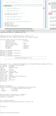

I am trying to debug an external application with an ST-Link coming together with my Nucleo-G070RB board. I tried all three available debugger probes in CubeIDE: ST-Link (Open-OCD), ST-Link (ST-Link GDB Server), and Segger J-Link. they all failed.
The pins used for connecting the external application and ST-Link: VDD from target, GND, SWDIO, SWDCLK, Reset
The console messages when setting the debugger probe to ST-Link (Open-OCD:(
At debug start:
after clicking on Step-Over:

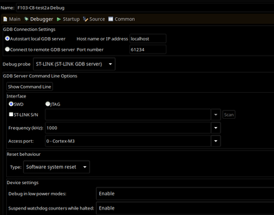

your first setup with ocd looks not bad, just try with lower speed + software reset , see:
Maybe your cables are long (> 20cm ? ) or you have EMI /spikes on ground, then always problems.
Try short (max. 20cm) wires, "good" ground (from same mains plug , no or small loops ).
2024-02-26 1:04 PM
Thank you for your reply!

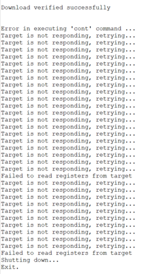

Applied your setup (Debug probe of ST-Link GDB Server, lower speed of 1000KHz and software reset), but still got the "target no device found" error. Same error for all reset options but Connect under reset.
Then changed reset option to Connect under reset, and got the following result:
But when clicking on Step-Over the HAL_Init() function, error occurred:
