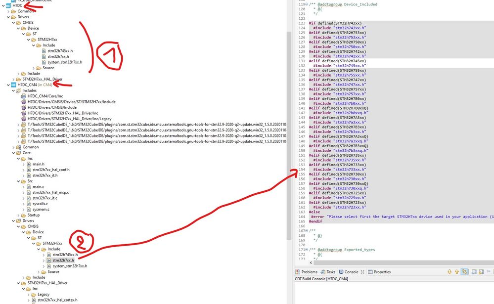

Guess I've understood your issue here.
You don't have proper highlight because file you're looking at is not part of your project. Part of your resources but not part of project.
Playing with complex target device (multi cpu here) you are exposed to a hierarchical project structure. You have a top most project which is not a CDT (C/C++) project but kind of repository to host x2 (one per cpu suffixed so _CM4 & _CM7) C/C++ projects.
Let's look at such snapshot
Your're looking at file located at (1). Such is "common" to both C/C++ projects but hosted as part of top most project. This way Eclipse + CDT are not able to run properly file indexer on. Such feature is only working within same project context.
I've got try to copy (1) to (2) so from top most repository to CM4 dedicated project. Let's look at ... editor is promoting expected highlight then.
Some drawback so of code dupes prevention I guess ...

Very interesting! What you described is indeed my issue. I'm glad that copying the common files (1) onto the specific project (2) work for you.
I have tried a similar method. However, in my case, I created a linked folder from (2) to (1). However that didn't work. It seems like copying those files might be the only way to go.
2021-02-26 3:35 PM
I guess duplicating the common files in the sub-project is the only way to go for now.
